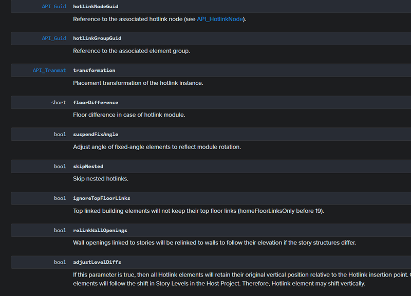

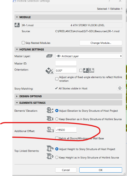

Hi
Anyone has an idea where can i configure the hotlink additional offset under element settings?
https://graphisoft.github.io/archicad-api-devkit/struct_a_p_i___hotlink_type.html
I dont think this is available in the hotlink element
1 REPLY 1
Akos Somorjai
The only place that information may be available on the API is the z-level adjustment of the transformation matrix; although I'm not sure you can set it via that member.
