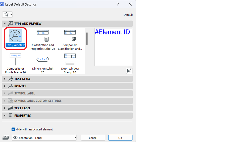

I am trying to create a new Text type label. I want it to be of Text type regardless of whether the default label is of Text or Symbol type. When I use the ACAPI_Element_GetDefaults function to get the default data of the default label, I didn't find a way to modify the default to be Text type label when the default label is of Symbol. If there is another way to create a Text type label whether the default label is of Text or Symbol type I would love to hear about.

I'll definitely try out the solution you suggested, I'm just wondering if there isn't a simpler way to access the text/autotext label shown in the label object's settings...

I don't think there's a general easy way to set it up.
If your situation allows it though, you could setup a favorite for the text label and get the basic setup then from that with ACAPI_Favorite_Get.
You might also find ACAPI_Favorite_Import and ACAPI_Favorite_Export helpful. Then you could store the favorite as a file and distribute it alongside your Add-On.
