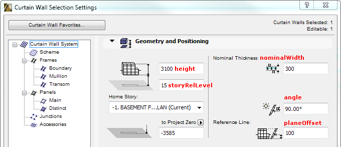

I am looking for a way to get the following information about the curtain wall:
- Curtain Wall Height
- Bottom Offset to Home Story
- Nominal Thickness
- Slant Angle
- Reference Line Offset
Based on the documentation, the following could be the values that I am looking for, respectively:
- height *
- storyRelLevel (EDIT: this is actually found on planeMatrix but you need some more calculations)
- nominalWidth
- angle *
- planeOffset
* Based on the documentation, these two are for input only.
Only nominalWidth has value and everything else is 0.0.
Where and how can I get these other values?

I temporarily use the following codes to get the height and storyRelLevel:
API_Box3D extent;
ACAPI_Database(APIDb_CalcBoundsID, &cwall.head, &extent);
double cwHt = extent.zMax - extent.zMin;
API_StoryType story;
GetStoryType(cwall.head.floorInd, &story);
double cwLv = extent.zMin - story.level;
*GetStoryType() function returns API_StoryType of a given floor index.
