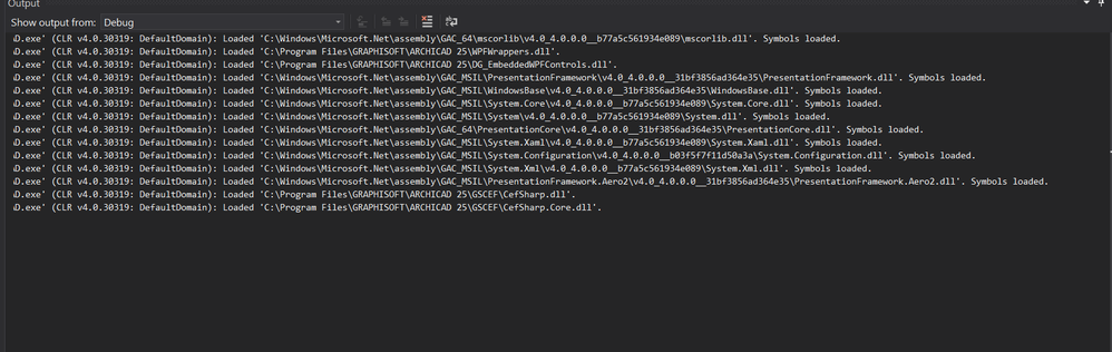

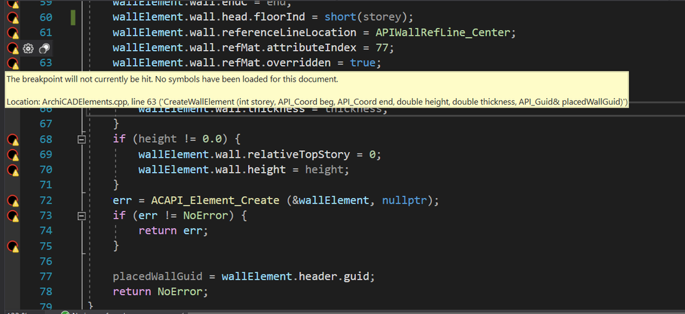

Dear Community,
I'm encountering a problem with debugging in Visual Studio on Windows. Despite setting up everything correctly, the breakpoints are not being hit, and Visual Studio warns that "No symbols have been loaded for this document." We have ensured that symbols are loaded from the system.
Also Enabled tools for debuggung on Windows as mentioned here.
Attached are screenshots of the debug output and our configuration for your reference. Any insights or advice on what we might be missing or doing wrong would be greatly appreciated.
Thw warning message on debug modeThw warning message on debug modeDebug configurationDebug configurationDebug output after attach prossess as Archichad.Debug output after attach prossess as Archichad.

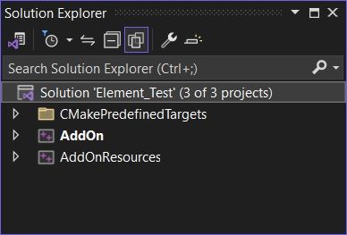

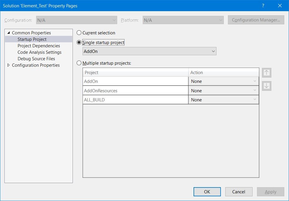

Make sure the AddOn project is set as your startup project
You can change it from the solution properties
Then clean and rebuild the project/solution. Check if a .pdb file has been created in the output directory. And finally follow the steps from the previous post to start debugging.

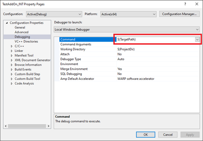

I don't have any problems with debugging Add-Ons, this is the way I do it, maybe it will help.
  1. Compile the Add-On.
  2. Load the Add-On in Archicad using Add-On manager. Make sure that you load the compiled Add-On by specifying it via the path of the Debug version of your Add-On.
  3. Set the Add-On project as startup project in Visual Studio, and set your installed Archicad.exe path as the command for debugging.
  4. Hit F5, it will start Archicad, and debugging should work.
Please note that if the Add-On is not preloaded, the breakpoints will be active only when the Add-On is used, and before that you will see inactive breakpoints.

HI @kolioi
Thanks for the reply. I tried with same setup but the .pdb was not created . Is it beacuse of the version issue?
This is my build output.

As we can see that there is no .pdb file were created. this causes the debugging prossess.
Any solution for this? Thanks in advance
