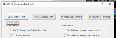

And if I hover over each control, I can see the name assigned to it.
For the first button, it is correct:

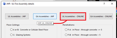

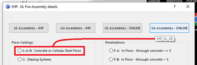

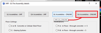

For the second, third, and fourth buttons, they are one off:

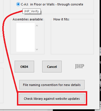

This offset continues throughout all the controls, until the very last one that is defined and the number of the offset has increased.
