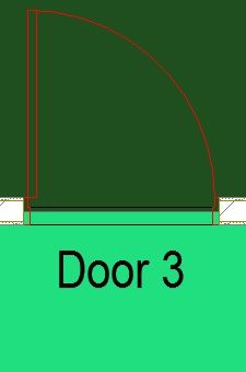

I am able to get the doors on a zone using ACAPI_Element_GetRelations(API_RoomRelation). But what I found out is that this is applicable to doors where its face/surface touches the edge of a zone.
I am having trouble now getting the doors where they are in the middle of two zones. (see attached image)

In API19 ACAPI_Element_GetRelations function is extended and you can call it for doors and windows also.
Example code:
API_Element			doorElement;
API_DoorRelation	doorInfo;
err = ACAPI_Element_GetRelations (doorElement.header.guid, API_ZombieElemID, &doorInfo);
if ((doorInfo.toRoom == myRoom1Element.header.guid && doorInfo.fromRoom == myRoom2Element.header.guid) ||
	(doorInfo.toRoom == myRoom2Element.header.guid && doorInfo.fromRoom == myRoom1Element.header.guid)) {
	// this door is in the middle of myRoom1Element and myRoom2Element
If you check this for each door then you can get all doors on the zone.
