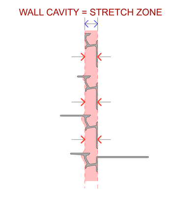

In the screenshot below I have placed a few of the profile options and indicated the zone where any stretching is most likely to be wanted (basically within that part of each profile that sits within a typical 20mm wall cavity, immediately behind the outer cladding layer.  There are a few exceptions where a wider zone is needed to capture both ends of curved edges that straddle the edge of the cavity zone (not including both ends would cause curves to distort too noticably)
Sometimes the inwards stretch needed can be from one or the other side only, or sometimes both, depending on what else needs to be drawn passing beside the profile within the wall cavity.
I have also attached the current version of the object so you can see my starting point.

Pertti Paasky
In this case I would  create  2d polygons  for every alternative so that they have the same coordinate origo.
Too much work with "intelligent" solutions.
