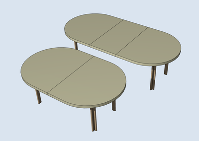

Hi! Is there someone here who understands GDL language? I usually model my own products, but I was curious to try modeling via GDL with my friend ChatGPT, and it didn’t go well.
As you can see, GDL is not my strength and I honestly don’t really know how it works, and wanted to test it if it would save some time - so please bear with me.
I’m just curious if it can model anything at all. I tried creating an oval table with a full bullnose top and cylindrical legs. But every time I added the script as a new object, it gave me an error — line by line — always saying “MISSING CALL.” Fix one line, and then another line would trigger the same error. Nightmare. How is this legal to work this bad? why not to say all the errors at once?
Anyway, in the end, it was recommended that, for an oval table with a bullnose top and cylinder legs, it’s actually better to leave the GDL scripting (LOL) and instead:
Use the Archicad Object Tool wizard to create a parametric block + cylinder table interactively rather than hand-coding.
Set all parameters (width, depth, height, tabletop thickness, leg diameter, leg offset) directly in the UI.
This avoids all MISSING CALL or sweep2 issues and ensures the object is fully adjustable in the Settings dialog.
Is there someone here who knows GDL and can confirm whether it really has these limits? Am I better off modeling objects the way I usually do? What is the gdl language used for then?
