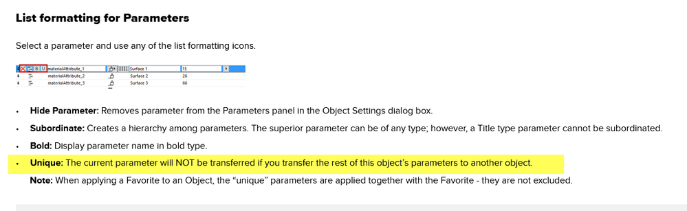

What does the "U" button/letter mean in front of parameters in Archicad?
Tai ChenYi
In Archicad’s parameter list, every parameter seems to have a "U" shown in front of it (for example, before AC_show2DHotspotsIn3D).
What does this "U" stand for, and what is its function?
Thanks in advance for your help! 🙏

U = Unique.
From the reference manual ...

U = Unique.
Got it. So the point is to prevent that parameter from being passed to another object, like special marker text (e.g., the 'X' symbol explanation).
Thanks for clarifying!
