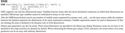

There should be someone who knows more of the GDL stuff than I do to tell me. When creating PARAMETERS that I want to be an ARRAY so that they can be used with MOVING HOTSPOTS, all I have found is that I have to define them in the "Parameters" tab, not in the MASTER or PARAMETER window.  This means that I have to give a dimension on the array size; I am not able to have an infinite or undefined size.
Is there a way to define an array (x[][]) that can be used with Moving Hotspots that does not have a limited size?  Thanks
2 Replies 2
B_Migito
What you're looking for is DIM
It can be used to create arrays with arbitrary dimensions
