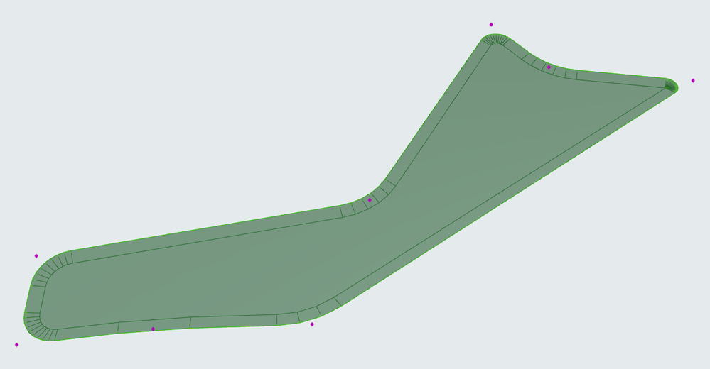

Now, how to "DELETE verts" so that the OBJECT can be adjusted.  Think of a POLY with "verts" quantity that can be adjusted in a variable.  This application is a detention pond with "n" number of corners that can be added or deleted as needed for the design.
In the attached image, each pink dot is a moving hotspot for a corner of the pond.  The number of corners needs to be adjustable through the design process.
