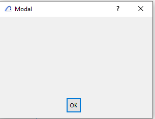

Good day everyone. I need a help with understanding the GRC nature in order to properly define modal dialogs and other appereances.
I wonder if there is a documentation like cppreference but for GRC so I could understand this scripting language better?
I am trying to define the modal dialog, however, I get stucked with some errors sometimes when trying to add styles or else.
For example:
Here I made a wrote a simple grc for this modal dialogue...
How can I get rid of that question mark thing?
ChatGPT gave me this solution:
'GDLG' 32525 Modal 10 10 300 200 "Modal" {
Style NoResizing, NoHelpButton // Add this line
/* [ 1] */ Button 130 160 30 30 LargePlain "OK"
However, this solution seems not being properly built when I press "Build" button to build the final project in Visual Studio.
Now I am completely lost how the syntax is organized in GRC. I need help please.
Thank you in advance!
Operating system used: Windows 10
