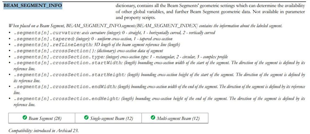

How to get BEAM_PROFILE_NAME of all segments in label gdl script?
I cannot find how to retrieve segments profile name list, even after checking the manual.

Have you looked through the returns of beam_segement_info?
HKM
not found profile name or profile index in beam_segment_info in reference guide.
note)target beam is Multi-segment Beam (12) with complex profiles.
Lingwisyer
Guru
I was wondering about what the cross-section data of segement dictionary was. Thought it might be a dictionary of all of the involved cross sections, though that could be just node information without any reference to the name...
