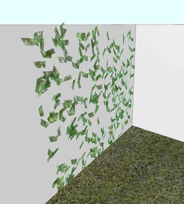

There´s this hedge in archicad I used before, but it takes to much time to render and I believe if I use a real green wall/hedge object it will look more realistic.

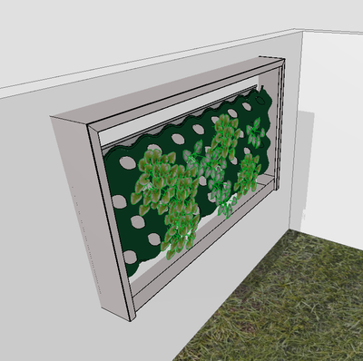

Then there´s this object by Humko, but again I didn´t like to have this metal and support, as I´m only interested in the vegetation.

If you are wanting plants to look realistic, I would advise you replace them in what ever rendering package you are using due to the reason Runxel pointed out.
Regarding the Humko object, if that is a native AC object, you ask the creator, or dig into it yourself, and disable the framing. The vegetation looks like a called subroutine so it should be possible to isolate.
