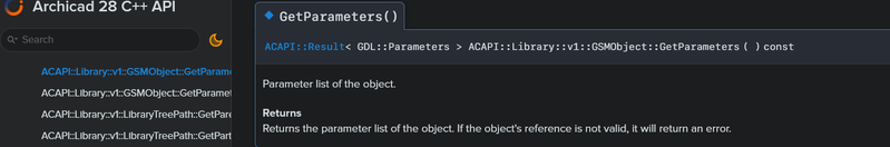

Yes, some functions like: ACAPI_LibraryPart_GetParams() are marked as "Legacy function - to be deleted in future versions, use ACAPI::LM::GSMObject::GetParameters instead".
I went to check for "ACAPI::LM::GSMObject::GetParameters" and found this:
So far I checked out these functions:
ACAPI_LibraryPart_GetSection(),
ACAPI_Element_GetComponents(),
ACAPI_Element_GetMemo(),
ACAPI_LibraryPart_GetParamValues(),
API_Element(),
ACAPI_LibraryPart_GetActParameters()
But none of them gave me these information:
So I wonder if you managed to extract these data somehow
