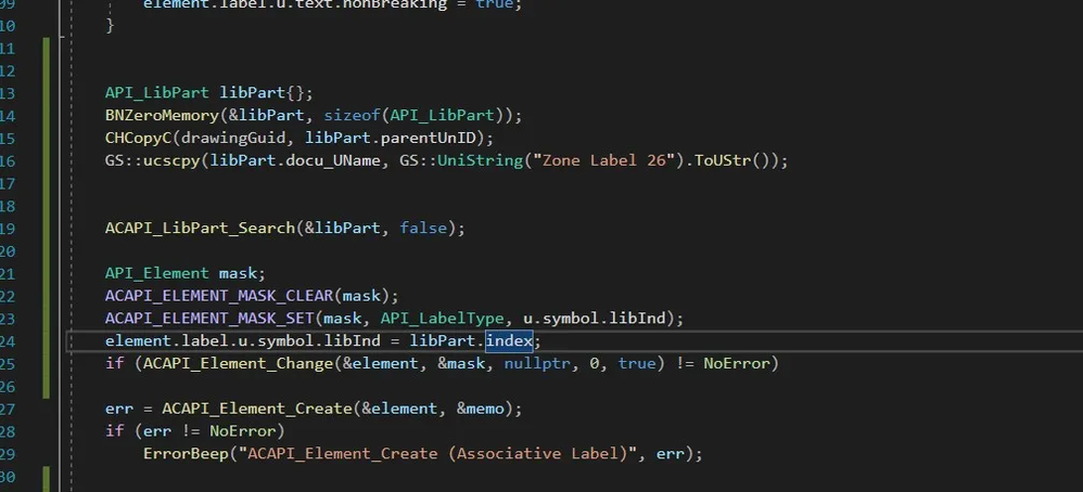

Hi bschwb,
Thank you very much for responding to my question.
I followed your instructions but it doesn't work. Can you check my code? And tell me where I'm wrong?
Thanks in advance
Please provide the code in a code block for us to copy from. Screenshots of code are very cumbersome to use.
And also please provide more details of what is not working. What are the error codes you get in which lines etc.
After a quick look on your screenshot, I'm confused why you are using both ACAPI_Element_Change and ACAPI_Element_Create. Are you trying to create a label or change an existing label?

Your code has a few errors and unnecessary lines, so I changed it quite a bit.
First, you don't need to create and then change the label.
I think it's easier to set it up correctly first and then just create it.
Here's an example code for an independent label (it was faster for me to program),

  // In case a text label is selected in label tool defaults, we switch to a symbol label.
  if (element.label.labelClass == APILblClass_Text) {
    element.label.labelClass = APILblClass_Symbol;
  API_LibPart libPart{};
  GS::ucscpy (libPart.docu_UName, GS::UniString ("Zone Label 26").ToUStr ());
  err = ACAPI_LibPart_Search (&libPart, false);
  if (err != NoError) {
    ACAPI_WriteReport ("Error in LibPart_Search: %d", true, err);
    return;
  element.label.u.symbol.libInd = libPart.index;
  // We need to get the parameters of the actual library part!
  // They are stored in memo.params
  API_ElementMemo	memo{};
  Int32 addParNum = 0;
  err = ACAPI_LibPart_GetParams (libPart.index, nullptr, nullptr, &addParNum, &memo.params);
    ACAPI_WriteReport ("Error in LibPart_GetParams: %d", true, err);
    return;
  // Create label
  err = ACAPI_Element_Create (&element, &memo);
    ACAPI_WriteReport ("Error in Element_Create: %d", true, err);
    return;
  ACAPI_DisposeElemMemoHdls (&memo);
Hope that helps!
