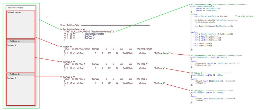

I made a simple sample. (attached image)
This is the undocked state, but it's working fine in our environment.
This roll-down palette has a structure like a parent with multiple tab pages as children,
Each tab page has its own resources and classes.
The parent page has a class but no resources.
(The resource in the green part of the image is just the text provided for the child palette heading)
I also wanted to specify grow as an argument if the parent resource exists
Cannot be specified because the resource itself does not exist.
I think that the child tab page is probably not related to docking
These are also tab pages, not palettes, so I don't think grc has any items related to docking.
