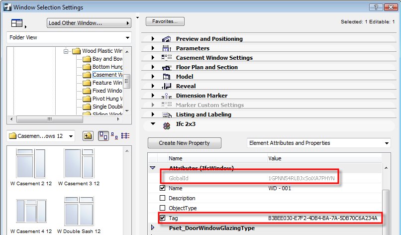

I checked a Window Settings Dialog and it seems there that both the IFC GlobalID and ArchiCAD GUID are displayed and checked by default.
Are you saying that when this is exported from ArchiCAD, the GUID is lost?

You are right. I tested this again and the ArchiCAD GUID for doors and windows exported to 'tag'. My settings were maybe wrong.
