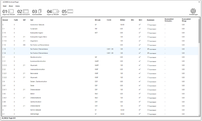

im a big fan of the DG::Browser Dialog and i made the whole gui as a browser dialog since i like html a lot better then the DG Framework 😄
