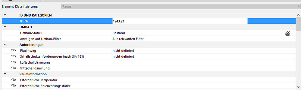

Where is this "Compact Element ID" information stored?
In Archicad it is found in a Zone Settings under Categories and Settings -> ID & Categories.
In the same group I see the following data (im using the CHE Version):
Element Classification: Room
ID-Nr. : XXX (This is the Information I want)
Renovation-Status (Umbau-Status): XXXX
Display in Renovation-Filter (Anzeigen auf Umbau-Filter): XXX
I have looked at the documentation for: API_​ElemCategoryID, when I use the suggested code* I get the following 6 key value pairs:
+("Anzeigen auf Umbau-Filter", "Alle relevanten Filter") -> API_ElemCategory_RenovationFilter
+("Element-Klassifizierung", "Raum") -> API_ElemCategory_ElementClassification
+("Klassifizierung nach DIN 277", "") -> API_ElemCategory_BRI:APIERR_BADPARS
+("Lage", "") -> API_ElemCategory_Position: APIERR_BADPARS
+("Tragende Funktion", "") -> API_ElemCategory_StructuralFunction
+("Umbau-Status", "Bestand") -> API_ElemCategory_RenovationStatus
I am getting an APIERR_BADPARS on two of them. Is the API_ElemCategory_BRI supposed to be the Compact Element ID?
Why am I getting the error?

Dear mar_kq,
The ID you are looking for is in the elemInfoString member of the API_ElementMemo structure correlating to your element.
To query the contents of this memo, you can use the ACAPI_Element_GetMemo function.
Best regards,
Dénes
Thanks so much Denes, this worked.
ReignBough
For 19 above, you can use ACAPI_Database(APIDb_GetElementInfoStringID, guid, infoStr).
For full (hotlinked id+element id) id, you can use ACAPI_Database(APIDb_GetCompoundInfoStringID, guid, infoStr).
