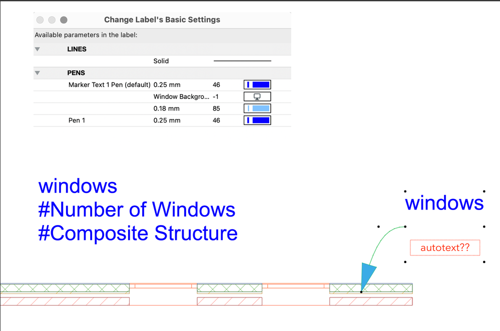

I am trying to create a simple "2D Elements as Label with autotex". But when I try to apply to elements the autotex is empty?
And can I have also the text from "classifications and proprieties"
Please see the image attached.
Thanks

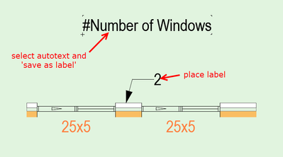

It is working for me.
Place autotext for what you want.
Select the text and then save selection as a label.
Place the label.

Maybe the label is not associated to the wall?
Is selected the wall and also i did the process by the book (Archicad Guide) , but is not working, have no idea what's wrong.
