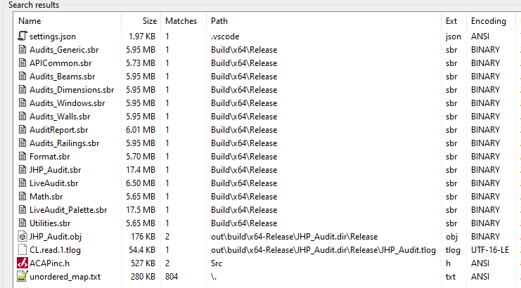

Here are results of a grep on my project files for unordered_map.
settings.json >>> the one instance is associated with "files.associations": {}
CL.read.1.tlog >>> is a log file that ties ..\TOOLS\MSVC\14.29.30133\INCLUDE\UNORDERED_MAP back to ACADinc.h
unordered_map.txt >>> is a file I saved of the text in the output window after the build
ACAPinc.h >>> appears to be the culpret.  The two instances in this file are the #include and the usage as an argument in ACAPI_AutoText_GetNoteAutotexts().  This copy of ACAPinc.h is dated 8/14/2023 3:14:52 PM and appears to be the latest.

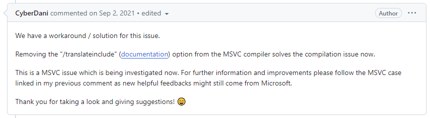

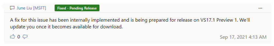

I have read about a different bug with unordered_map and a fix HERE that implies using VS17.1
And another different bug with a workaround HERE that implies removing options from the compiler.
I am using VS2019, Tool set 142, Version 16.11.30
Would an upgrade to VS17 address my issue too?

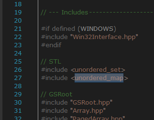

Thanks for showing an interest in my little problem here.  What follows is how unordered_map is being used in this project.  It appears that I am not using unordered_map() specifically in my code, but I do #include ACADinc.h  #include ACAPinc.h, which is the only reference I can find to it when I search 'Entire solution'.
In ACADinc.h ACAPinc.h [dated 8/14/2023 3:14 PM]:

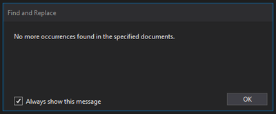

Maybe I have a different configuration issue that does not allow me to find ACAPI_AutoText_GetNoteAutotexts?  I also notice that all the function definitions above and below this one have the same 'not found' message and green squiggle underline.  Could that be an indication of why my build is being so grumpy about this???  Not sure...
Regardless, a search in VS...
...only finds the two results above, and then this.
The attached .pdf file is output from build.  Maybe that helps too...
