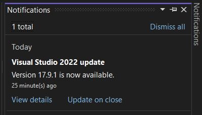

kolioi
Archicad updates are done manually - you have to check if there is new version of the app and/or the library (go to Help --> Check for Updates...). On the other hand Visual Studio does this automatically - you see a notification like this
In both cases you have to close the app and then make the update.
More details on the update - later.
