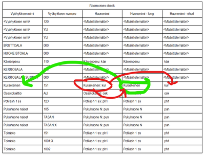

thanks for that, here are some screenshots to explain what I am trying to achieve so hopefully makes it clearer.

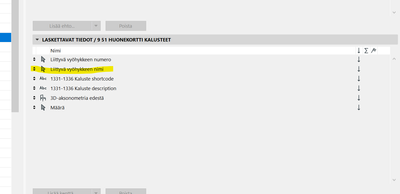

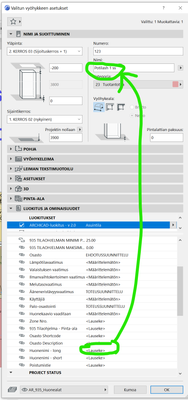

Firstly instead of entering room name in the Zone room name box (1000's of rooms being entered by different team always results in variations of the same room names in different parts of the building...) I have created a property which is a drop down list of all room names used in a project along with a shortcode (eg WC:Toilet), then I have used an expression to extract the shortcode and room name into new properties.   This works well for most things I want to do like labelling rooms, extracting schedules, etc, but when I want to create a schedule that tells me what elements are in a particular zone I need to use the "related Zone name"  parameter to return the name of the room along with the Zone number.
So was wanting to find a way that I could automate the process of transferring the selected room name from the property to the Zone name parameter box.  I have set up a schedule where I can copy / paste from the property to the name parameter, but as this is just repetitive and I can't see anyone really wanting to sit down and repeat this process 1000's of times across a project, was wanting to make it more painless...
The red bits are currently done automatically after selecting the part in the circle, so now I want to automate the green bit.
Thanks for any help.
