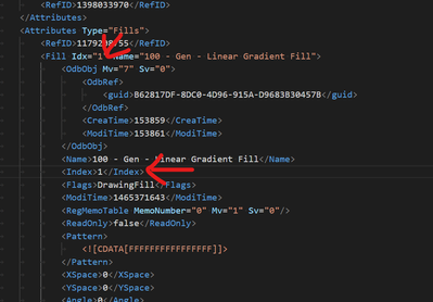

That said, I have recently messed around with exporting the attributes to XML and then manually editing the index numbers there and then overwriting the attributes with the modified XML file.
However elements or associated attributes will not have their attribute index number updated based on your modifications, so you are likely to get a lot of incorrect attributes allocated or MISSING attributes.
It works pretty well if you are restructuring your template, but not practical on a live project.
The need for a bulk reindexing functions has been requested ever since they introduced the reindexing function, but suspect it's not high priority on the roadmap.

Editing attributes file using xml editor is a good idea, BUT, afaik, Archicad xml files are mapped in special way that can' be easily saved , so that's why all changes you made on the file were unavailable,  i played with xml classification file, and i had the same result, a gile that didn't work correctly
