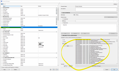

I've been exporting BIMx Hyper-models and noticed that certain properties make it into the export while others don't. For example, one specific property exports perfectly fine, but I can't see what sets it apart from others that aren't included.
Anyone have any insights or experience with this? What am I missing?
I thought maybe there was something in the IFC translators, but couldn't see a matching name.
In addition, there is a schedule "IES-BX Default for BIMx output", I attempted to add some new properties here, but these also didn't come through.

The mapping looks like the properties are tied to your CBI classification rather than an IFC classification system. Seeing that your property is set to custom, you may have missed its classification assignment. I would duplicate the property and set it to all classifications as a test, so you don't break what you have already and test it. You don't need to export to BIMx to check, you just need to open up the IES to see the information and see where the gaps are.
If there are no gaps in the schedule in Archicad, and the gaps appear in BIMx then I would assume it could be a bug.
