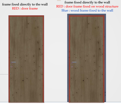

a frequent exemple for me is a wood structure for wooden doors, let's call it a "pre-frame",  it's fixed on the maconnery, and helps to keep an exact reseration for the wood door,

The result :
