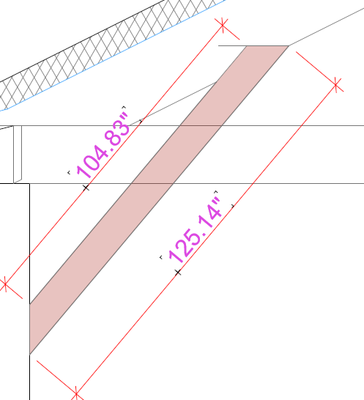

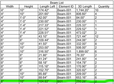

Creating a beam schedule, we're used to using "Length Left" for beams, but it's not taking the mitred ends into consideration as they are opposite the beam length (example:)
 Okay, so to get around this, I have found that "3D Length" shows the accurate beam length (125.14"). However, when put into the schedule, the "3D Length" items are summed together when the "Length Left" items remain the length for one individual item (which is what we want).
See highlight for beam shown above. Quantity is 2, so we are seeing 3D Length as 250.28", but we just want the individual length of 125.14" to show. Any ideas?

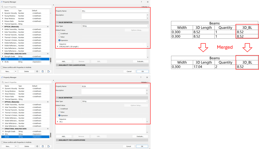

Create a new String property (Ex: 3D_L) available for Beams with the expression: STRCALCUNIT ( 3D Length )
Creat a new String property (Ex: 3D_BL) avaliable for Beams with the expression: 3D_L
Add 3D_BL to your Schedule
I don't know why the first one is merged even as a string, but if you create a second one just like that it is not merged. 🤔

Thanks, I'm giving that a try but I am getting "Syntax error in Expression" when trying to create the new String property STRCALCUNIT ( 3D Length ). I think I might be missing a step?
Do not write "3D Length", you have to select it from the list of properties it should appear with a grey background.
M. Arch. Ricardo López
Thank you, that worked, just had to add the parenthesis manually and I think it's working as intended now. Appreciate your help!
