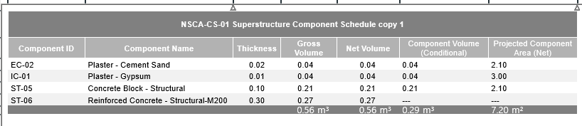

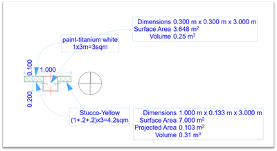

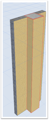

I am trying to extract accurate paint/finish quantities for a real-world structural condition where a structural Column intersects wall and is wrapped automatically by a composite Wall skin. (Refer plan & 3D)
The Model Configuration:
wall is 1m long X 3m tall (Concrete block (intersection priority 750) +gyp plaster (IP-220) - finish (Titanium-white) +Cement sand plaster (IP-640)- finish (stucco yellow)
Column is 0.3x0.3x3m tall (wrapped)(Reinf conc core (IP-800)(no veneer)

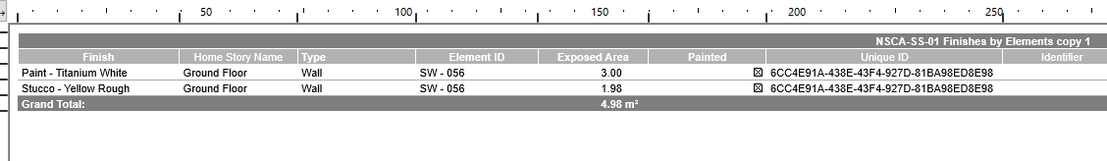

Surface Schedule (Exposed Area parameter):
No matter which scheduling method I use, Archicad refuses to calculate the true unfolded surface area of the wrapped protrusion(Stucco-yellow) (which geometrically should be 4.20 m²). Instead, it falls back to a flat bounding calculation(1.98sqm(?))
The Problem with Scheduling:
  1. Component Schedule (Projected Component Area (Net) parameter): When scheduling the literal material skin (Plaster - Cement Sand), Archicad completely ignores the 3D jogged geometry of the column wrap. It evaluates the 1.00m wall length deducted by column 0.3, strictly by its flat centerline projection (1.00m length × 0.7m height), yielding exactly 2.10 m² (flat face area) and omitting the depth of the column flanks entirely. (It should be 4.20 sqm)
