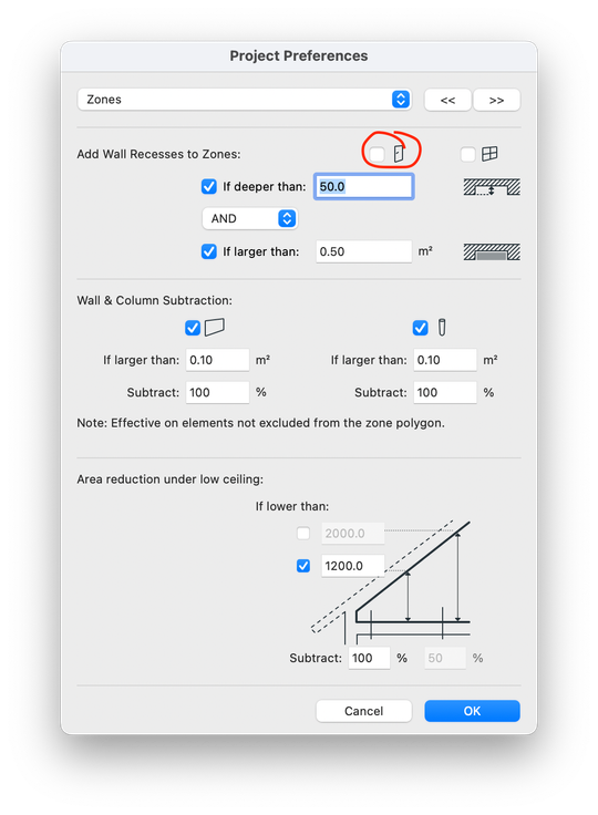

I haven't tried it but does changing the 'add recess to zones' setting have any influence upon this?

Hi Lee,
It looks like there isn't any influence -- maybe because they aren't recesses and instead full openings? We also are trying to not count those interstitial spaces to our net room area, but maybe that's the lesser evil.
Thanks for the suggestion!
