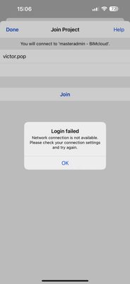

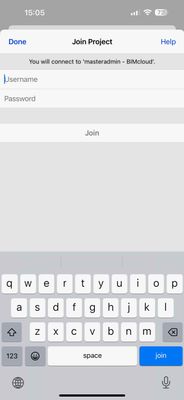

Perhaps I'm doing something wrong but on a video on Youtube, BIMx is presented as an integrated solution for on-site to in-office communication via BIMx App.
I uploaded a model to BIMx Model Transfer, downloaded it on my mobile device, but when I click on join and enter my username and password in order to leave messages for my colleagues at the office, it says "Login failed" - and I'm certain I didn't get my password wrong.
Is there something I'm missing here?
What's more, on my laptop, I've downloaded the BIMx App, clicked on BIMx Model Transfer which takes me to our companies' profile, and when I download the file, it downloads a very weird file which BIMx can't open.
Any thoughts?
Thank you
