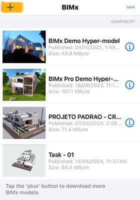

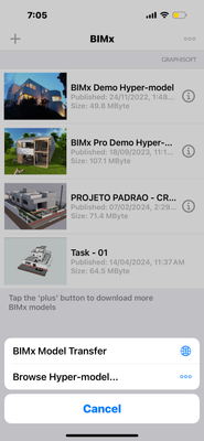

Hi @user-jose,
When you install BMx app on your Iphone, press the plus button to add a new model.
Then you’ll have to choose between downloading from BIMx model transfer site or browsing inside your phone files.

I did press the + button try to download it from my I cloud files , that is when the strange message "Document can not be imported. The file format is invalid" appears. I have not tried the other method but I will soon.
