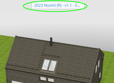

I was trying to publish BIMx model with different Design Options into BIMx cloud. But somehow I'am not able to swap between design options using 3D Model Switch.
How we should publish models so this handle of swaping design option will work ? ? ?
My dropdown model switch don't have any other options 😞

It seems your Hyper-model includes only one 3D model. Instead of the easy but limited Publishing Wizard, use the detailed method in Publisher to save multiple 3D Views into BIMx's Publisher Set.
