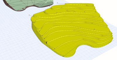

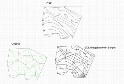

Made some progressions for using AI (Gemini and Grok) to "script for me" some phyton-scripts to read out the data from 2D and 3D-GDL-Scripts and make additional 2D and 3D-scripts to put in the existing GDLs to get some additional 3D and 2D-results.  Proof of concept..

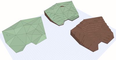

Example: i made a terrain with Archicads normal tools - transformd this into GDL, copied the GDL-scripts into normal textfiles and made the python read this and created new GDL-Scripts for it.
 Works fine now after some iterations with the AI's. GemeniPro leads over Grok, but not far.
I do not know anything about python so far - its all made through the AI's
Just to know - You need propper installations of python3.12 and some additional python features like thinker and DXF-handling in python. The AI will lead You trough the installationprozesses when confronted with the errors, when phyton is not installd propperly.

Do you teach the AI to code in GDL or it worked from default already?
Hmooslechner
It works already - but not perfect. In every new "AI - development - iteration" - it works better. Half a year ago - it made just nearly unusable GDL-script code. Four month ago, it deliverd code, which began to work after many discussions and back-infos from Archicad's error-messages. Now, it makes mostly uasable code with very few errors in Archicad in normal situations and has just problems with "very special topics" on the top edge of GDL like simulating morphs in GDL or roof-tiling - "the golden Goose cases" in mathematics in GDL..  Wait some Time and it makes them too, i think..
