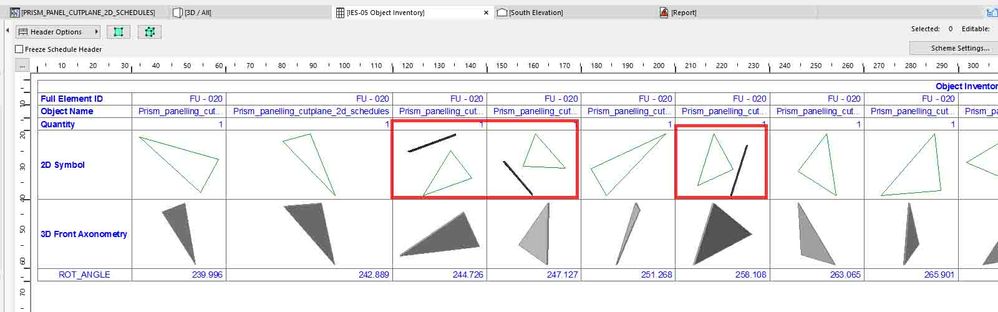

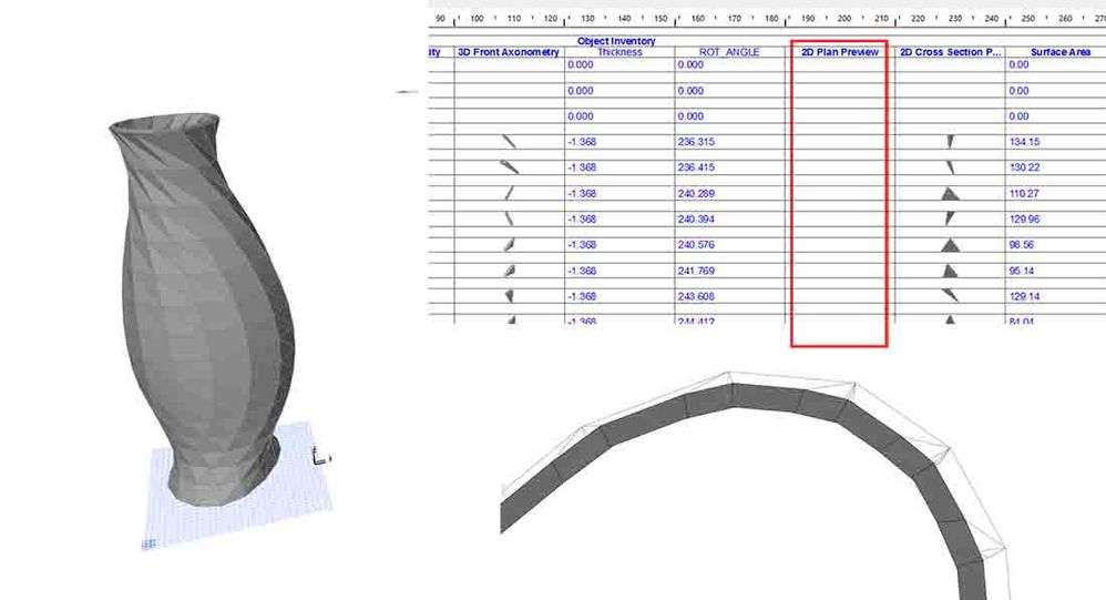

I am playing with the AC-GS connection and i have a tower covered with a simple triangular custom GDL object which has the right floorplan view settings.
I am trying to get a schedule and i would like to have the 2d planar projections of the object but it doesn`t work.
Can someone tell me how it can be done? I am also interested if i can enable annotations with basic dimensions in the 2d preview column

If i use Outlines or Overhead mode, then i do get 2d Plan Previews.
Is there a way i can get it while using Projected mode?
How can i get views that are erpendicular to each object face to see its true size?

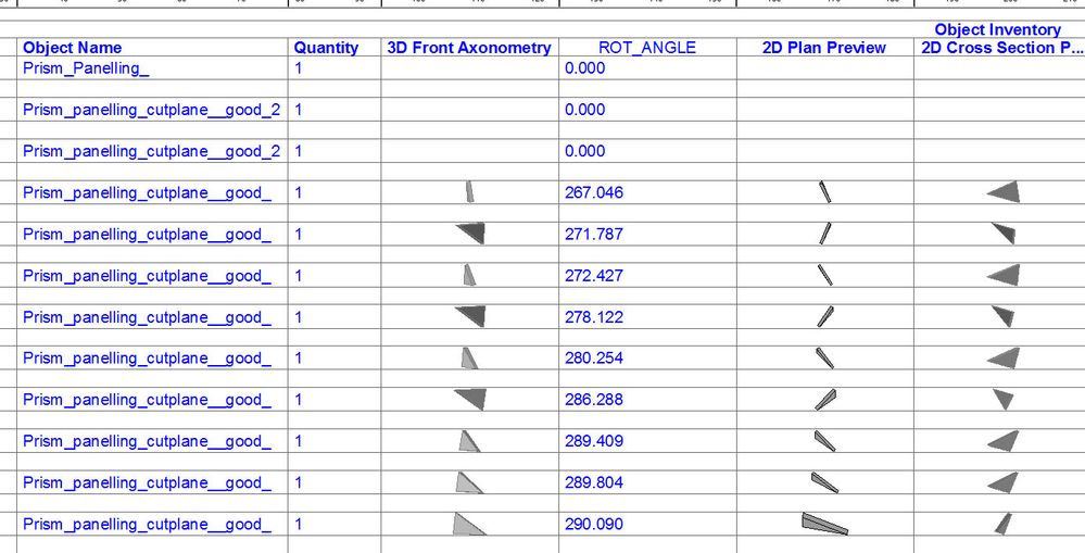

After a few tweaks i am getting both the floorplan cutplane view and the real size planar view for some of the panels...
