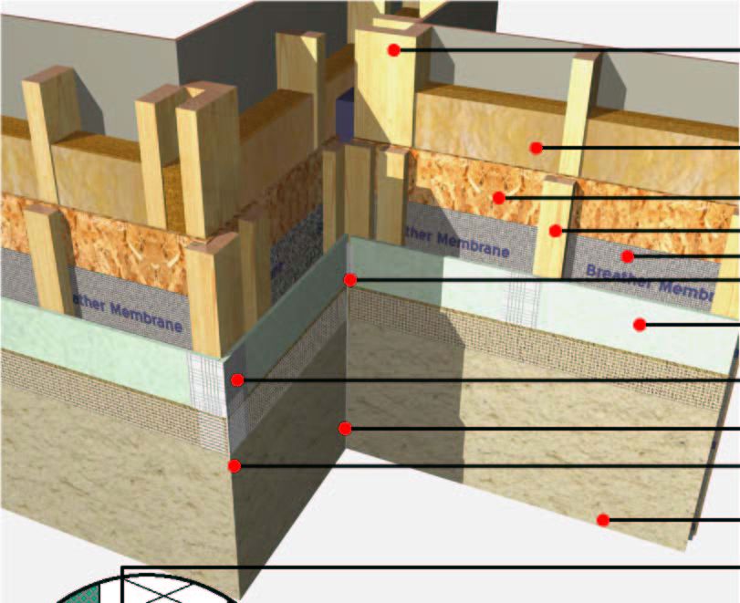

And this is the original as rendered in ArchiCAD as a comparison.
I have to say I find myself just staring in awe at some of these models, they are so absolutely stunning, and to hold them to apreciate the weight and solidity is eeven more impresive.
