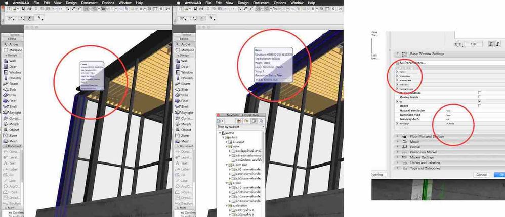

I have the font problem with Yosemite. The font in setting dialogue and tacker become super small. It's really difficult to read. Does anyone have the same problem? The thing is I'm using English (UK) as system primary language and once I switch it into Thai the problem seems gone. Is there anyway I can set the font bigger when I using English?
AC18 INT SOLO
OSX 10.10
I guess you are not aware that Graphisoft does not recommend upgrading to Yosemite yet:
GRAPHISOFT strongly recommends to hold off migration to OS X 10.10 Yosemite until further notice.
http://helpcenter.graphisoft.com/technotes/operating-systems/mac-os-x-10-10-yosemite/

The settings dialog closing unexpectedly is only an issue in AC 16 and older - these versions are not supported with OS X 10.10: http://helpcenter.graphisoft.com/?p=42283#Not_supported_versions

p_ckies
This issue hasn't appeared before either and I can't reproduce it on my machine with 10.10. We will try to check what can cause this phenomenon and will get back to you.
