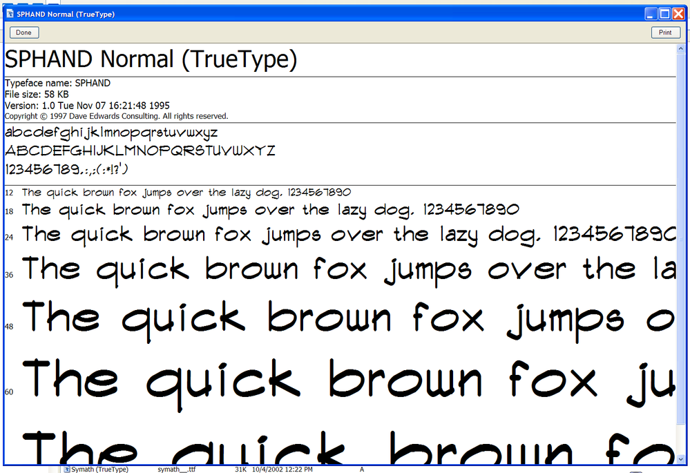

@Steve Jepson
Whats the name of the font you did use in your drawing above?
Thanks!
Steve Jepson
It's SPHAND.
It came with SoftPlan many years ago. I don't know if is still does.
Steve Jepson
sphand
and this is a new link to the SoftPlan Fonts Installer
https://softplan.com/?page_id=2819
I just tried it and it works. Installs the fonts to the Windows Font folder so they will be avaialble or use in ArchiCAD. I still use the SPHAND font quite often. Probalby more than 25 years now.
