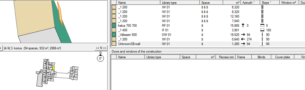

Having an issue exporting IFC from ArchiCAD17 to IFC to be opened in RIUSKA for energy analysis.
The problem resides in the fact that no window or door will be imported to RIUSKA once opened. (Also some space problems not mentioned here)
I tried different export options in ArchiCAD: I Checked
*Derived model data to export ->Space containment, Base quantities, IFC Space boundaries..., ArchiCAD zone Categories.
I also tried multiple import IFC options in RISUKA but nothing changed, I can actually see the windows (2D squares) in RIUSKA, but they are not in line with the wall. It seems that in Riuska you get the inner boundary of a wall but the window is "attached" to the outside of the wall and so in RIUSKA I can see the window but away from the wall as much as the wall is thick in ArchiCAD. Still no window is registred in RIUSKA under Doors and Windows of the construction.

UPDATE:
I got the windows and doors with "Improved junction Export" but lost all spaces and volumes.
The problem seems that, when choosing BREP in options I lose windows / not choosin BREP loses volume.
