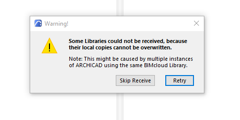

Hi all,
I am having this library issue with Archicad from the BIM server. I cant figure out how to fix it.
I have deleted the library on the BIM local data but in vain. Can someone advise please?

Do you have any antivirus on your computer? It might constantly locking all the files while you load the library, as they check it for malware. I suggest to put all Graphisoft related folders to an Exception list and check again if you can load libraries or not.

Thank you for that. I had researched the community platform. There was one person who mention to delete the library caches in the Local USER > local and roaming folders. I have deleted all the files and Archicad 25. It is working fine now. Hope this does not happened anymore.
