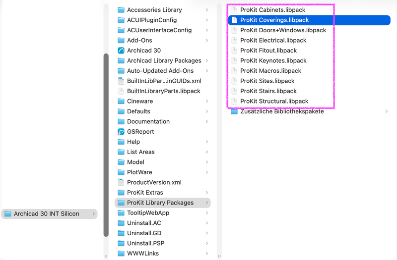

On successfully installing ProKit on a collaborate licence with AC30, when clicking a wall object, as an example, I get a message that says - ' Wall covering object could not be found, please make sure the ProKit Coverings library is loaded' .
Can anyone assist with how to properly load the Coverings library?

Hello @LGBOLADE,
have you loaded the libpacks for the ProKit? Did you load the individual libpacks (like ProKit Coverings.libpack) themself or the whole ProKit Library Packages folder?
If you loaded none or the folder, that might be the cause for the message.
Open the Library Manager under file > Libraries and Objects. Remove the folder from the library management and select the individual libpacks instead. Reload & Apply the library changes and confirm via OK.
Please note that in the Library Manager it's important to not add multiple version of the ProKit Libraries (e.g. Archicad 29 and Archicad 30).

Great! That worked. Thank you Charlotte.
