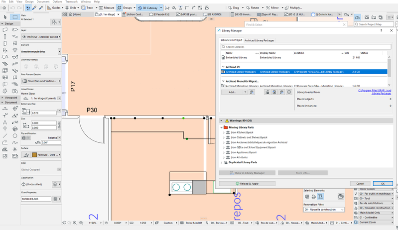

Library Parts appear as "Missing" even when loaded in Library Manager
I'm facing a strange issue in Archicad 29.
I'm working on a model that started on Archicad 27 french version leading to the current file in Archicad 29 english. The problem arose after a collaborator worked on it for the interior design. On a copy they made on Archicad 29 french on Mac...
I received their model, when I open their file I have no "Missing" objects. However since they worked on a copy and since the main file has changed elsewhere, my plan was to copy/paste their interior design into my file. When I paste their work on my file all of the assets appear Missing.
I still would love to know how to fix this issue or how to avoid it in the future because I risk running into it again.
Thanks
Operating system used: Windows 29.0.0
1 Reply 1
You appear to be loading the ‘Library Packages’ folder.
You can’t do that.
You must load each individual library package.
