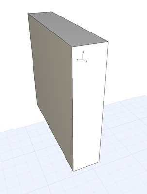

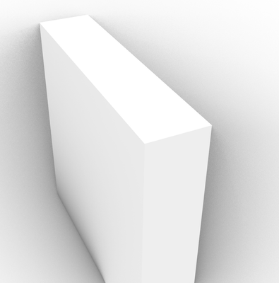

I want to export to rhino something like this wall, where one side is coloured, and the others are white. However when i export to rhino it converts everything to one colour. Would there be a way to get around this, have it make some intersection at the bisector inside the object?

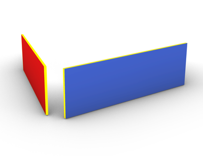

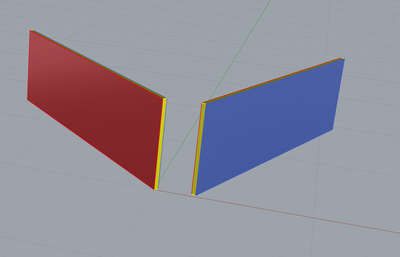

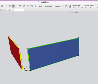

Mine works ok using "Save As…" in RH format from the 3D Window.
FWIW check the Rendered setting in Rhino since it looks like you are in "Arctic Mode" and with that setting RH will always render white
