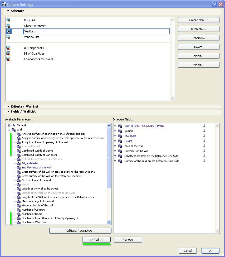

To save on manual calculations, try adding a few more parameters to the Wall List Schedule that is included by default. You'll find it under the Schedules>Element section in your Navigator.
Cheers,
Link.
I created a simple element schedule for this. It measures wall areas gross and net. It even totals them up at the bottom so you just subtract one from the other.
It can filter which walls in the project are measured according to material, fill, layer, storey etc. etc.
Link
Graphisoft Partner
Graphisoft Partner
Again, to save yourself any manual calculations, use the highlighted parameters in the previously attached image.
Specifically sum up the Analytical surface of openings... parameters.
Cheers,
Link.
