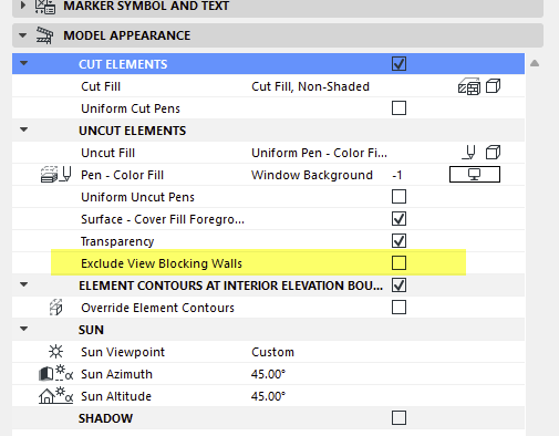

Several walls are present in the plans and I can see them in cross sections but they disappear in interior elevations. I keep the same layer combinations and the same characteristics for visibility but if they are frontal they disappear letting visible the other walls behind. The behavior seem random. In some interior elavation there is no problem, in others this problem appears. I cannot work with the interior elevations because of this randomness.

I found it out : Exclude blocking walls - what's the depth of this and where can it be changed ?

In the elevation settings, has the 'Exclude View Blocking Walls' option been ticked by any chance?

Hi Barry,
Thanks for including the image of the settings to clarify the topic.
Yes, that was it.
It took me a while to find it out and after covering some areas of the elevation with fills to remove the visible background ... I thought it was a bug because of the randomness.
The feature seams buggy. I would understand to have it when the IE line is on a wall and parallel with it, to allow removing that specific wall but not to remove walls from the background of the IE letting visible objects and other perpendicular walls with their composite structure... That is a strange behavior.
