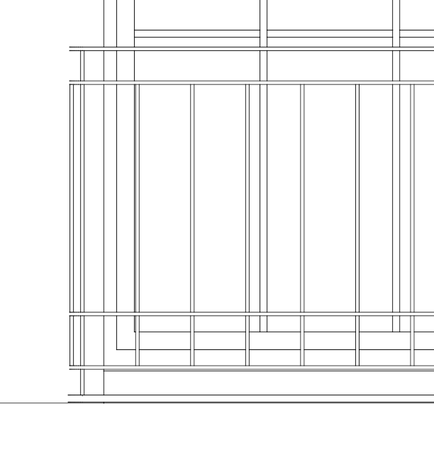

I am having a small issue where the ends of railings dont show up on corners when they go from parallel to the view to perpendicular.
I have attatched a few images showing the issue. When I move the end of the railing to be slightly out of perpendicular (10mm in the photo) the edges show up again but are obviously doubled up as you see where the railing meets the wall as well as the lines on the corner.
This is happening with both circular and square profiled rails.
Any advice on what is causing this or how to fix it would be great!

I fixed this when creating the stairs, in railing settings in segment menu I played with the creation or railing in baluster and with innter post. With baluster I play with baluster pattern distribution.
This happends because you set lenght between post 100cm and you changed lenght on drawing of youre whole railing and you stepped a 10mm over 100cm post division and than railing added a new post, because you stepped over set up lenght between post of 100cm over 10mm thats why he add a new post.
Please check post lenght and baluster distribution settings and find the best way it fit for you
