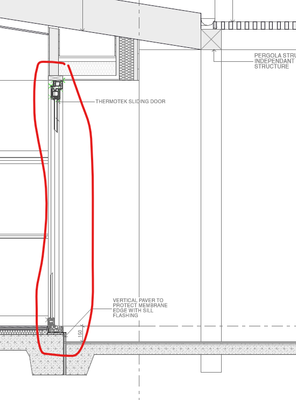

I've created a 1:20 detail section to show my pergola to house connection. For the purpose of this section, I would like the window to not show so I can use the 2D window framing instead. Please let me know ways to not show the window. What is the best way to do this?
As shown below, the window still shows and I only want the 2D aluminium framing on top to show.

Set your MVO for your sections to only show Openings for your doors and windows in 3D.
