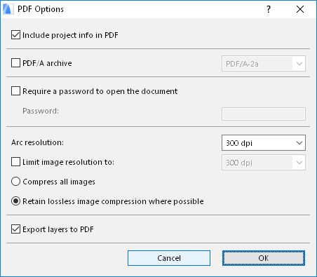

I'm experience some trouble when publishing PDF.
Using the save files option in publisher and choosing PDF format results in rather large files that are slow loading causing frustration.
Using cutePDF-printer results in a file that's almost 3 times smaller, and fast loading. The problem is cutePDF-printing is not publisher friendly.
I'm looking for a better way to save PDF. Anyone?
1 REPLY 1
Erwin Edel
Rockstar
You can set up quality (and as such file size) in the document options (pdf options) in publisher to some lower settings.
The settings below lead to acceptable filesize for my projects.
Things that would make for big file size:
images (JPEG and such)
vectorial fills with lots and lots of dots / lines
