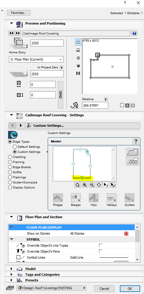

laz89 wrote:The fascia edge needs to be EXACTLY parallel with the roof pivot line to be able to get a "U" symbol available.
How do I get it to display a "u" symbol though? how do i check to see if the roof in horizontal or not? just check on elevation? i dont see how it would draw on an angle?

laz89 wrote:You're welcome. Probably no need to ask how I knew the answer. lol.
haha thankyou i would never have been able to think of that. turns out my "pivot line" or whatever its called was off by about 1mm so straightened it and now i can add a gutter and downpipe
