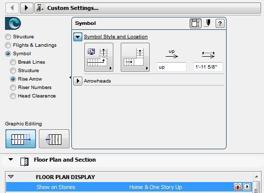

Just watched this on Youtube, but I do not seem to have this still or am I missing something?
I have been waiting patiently for the return of the polyline stair tool.

Its arrived, update this morning.

Are they back Yet?
If this is what you mean, then yes they are back.
Yes, thats what I mean, thats great But..
Ohh, I can't see it in my settings? is there any other settings you need to do before you can see the option, or it works different in AC 19?
This is what I'm getting
This is the settings from 19, it is slightly different from yours & mine from 18.
Have you checked your stair tool is up to date?

Hi, I check my Version of Cadimage Stair and is 6.33. But still not getting the option. I update my Archicad to 4013 and nothing. Does it matters if is an EDU license?
